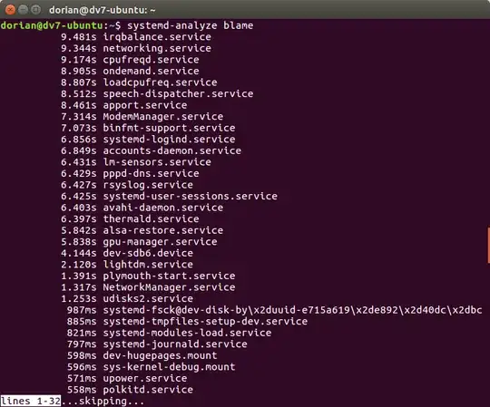

I've been using systemd-analyze to figure out what's causing the delays. So far I've tried the following:
  • Updated Kernel to 4.6
  • Disabled NetworkManager-wait-online service
  • Disabled Samba-ad-dc service
  • Disabled smbd service
  • Disabled mnbd service
  • Disabled and uninstalled apparmor
  • Disabled grub-common service

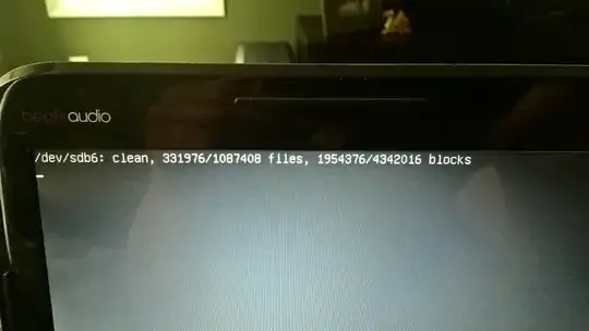

Here is the screen I see between the Grub menu and login screen: enter image description here
I'm aware this is fsck and it pops up pretty much right away after the Grub menu. I'm also aware that because it comes up right away, that it's not really taking much time. But that screen is what I see until the login screen comes up. No splash screen with scolling dots on the bottom, no purple screen.

Output of systemd-analyze blame (below)

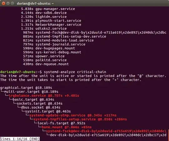

Output of systemd-analyze critical-chain (below)

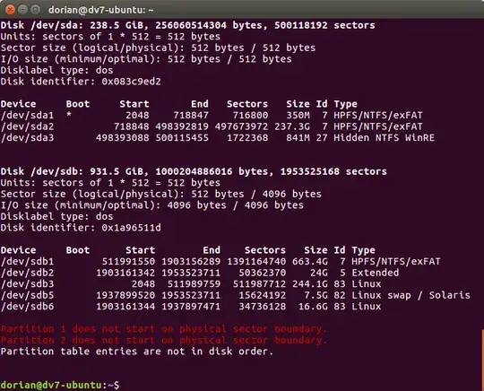

Here is the output of fdisk -l (below)
Like I said before, I'm using the same partitions as before (sdb6 for /, sdb3 for /home, sdb5 for swap). They were formatted. So I'm at a loss as to why this could possibly be happening.
sda is an SSD drive, sdb is a mechanical 1TB drive.

BLAME
  8.410s networking.service
  7.267s ModemManager.service
  7.138s accounts-daemon.service
  5.327s systemd-logind.service
  4.939s alsa-restore.service
  4.595s systemd-user-sessions.service
  4.166s dev-sdb6.device
  3.683s loadcpufreq.service
  3.455s apport.service
  3.353s ondemand.service
  3.261s cpufreqd.service
  2.063s gpu-manager.service
  1.643s polkitd.service
  1.508s rsyslog.service
  1.322s lm-sensors.service
  1.224s lightdm.service
  1.144s plymouth-start.service
  1.026s systemd-modules-load.service
  1.005s thermald.service
   918ms systemd-tmpfiles-setup-dev.service
   907ms avahi-daemon.service
   772ms systemd-journald.service
   534ms upower.service
Critical-chain
graphical.target @16.982s
└─multi-user.target @16.982s
  └─cpufrequtils.service @16.976s +5ms
    └─loadcpufreq.service @13.268s +3.683s
      └─basic.target @8.324s
        └─sockets.target @8.324s
          └─avahi-daemon.socket @8.324s
            └─sysinit.target @8.230s
              └─systemd-update-utmp.service @8.102s +127ms
                └─systemd-tmpfiles-setup.service @7.768s +333ms
                  └─local-fs.target @7.767s
                    └─home.mount @7.704s +63ms
                      └─systemd-fsck@dev-disk-by\x2duuid-e715a619\x2de892\x2d40dc\x2dbc17\x2d235e98e3ffe6.service @7.180s +463ms
                        └─dev-disk-by\x2duuid-e715a619\x2de892\x2d40dc\x2dbc17\x2d235e98e3ffe6.device @7.167s
