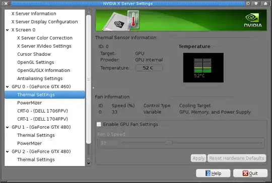

When I restart with Coolbits set to 5, I can enable fan control on GTX 460. I can also set it to maximum performance mode. I cannot change the clock frequencies. I am about to try different levels. But here is what I see (with Coolbits = 5):
alt text
Update 2: I've tried driver version - 260.24(beta - nvdeveloper) & 260.19.12 (released today). I am not able to see the "Clock Frequencies" tab for any of the 4xx cards. I can however alter the fan speed for the card with a display attached. I'm going to ask a second question and wait for better drivers to be released.

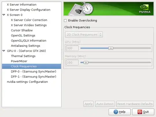

You almost had it. Coolbits is the way. Here's my device in /etc/X11/xorg.conf:
Section "Device"
    Identifier     "Device0"
    Driver         "nvidia"
    VendorName     "NVIDIA Corporation"
    BoardName      "GeForce GTX 260"
    Option         "Coolbits" "1"
    Option         "NoLogo" "True"
EndSection
And then (after restarting X - control+alt+f1, sudo restart gdm), load up nvidia-settings and there's a Clock Frequencies page:
