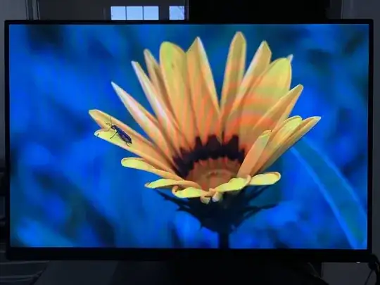

I want to use the two P40s as CUDA compute cards and have the GT 710 run the desktop environment, but I have trouble setting up Xorg and/or Gnome. In particular, the GT 710 only outputs a wallpaper on the monitor, but I cannot see anything else: no mouse pointer or login window, and it doesn't respond to mouse movement or keystrokes. Like this:
How can I get a usable desktop environment?

Remove the unnecessary and confusing inclusion of the non-graphical compute Tesla P40s in /etc/X11/xorg.conf:
# nvidia-xconfig: X configuration file generated by nvidia-xconfig
# nvidia-xconfig:  version 470.223.02
# Edited by https://askubuntu.com/questions/1502694
Section "ServerLayout" Identifier "Layout0" Screen 0 "Screen0" InputDevice "Keyboard0" "CoreKeyboard" InputDevice "Mouse0" "CorePointer" Option "AutoAddGPU" "off" EndSection
Section "Files" EndSection
Section "InputDevice"
# generated from default
Identifier     "Mouse0"
Driver         "mouse"
Option         "Protocol" "auto"
Option         "Device" "/dev/psaux"
Option         "Emulate3Buttons" "no"
Option         "ZAxisMapping" "4 5"
EndSection
Identifier     "Keyboard0"
Driver         "kbd"
EndSection
Section "Monitor" Identifier "Monitor0" VendorName "Unknown" ModelName "Unknown" Option "DPMS" EndSection
Removed: 2 devices of Tesla P40 type
Section "Device" Identifier "Device2" Driver "nvidia" VendorName "NVIDIA Corporation" BoardName "NVIDIA GeForce GT 710" BusID "PCI:68:0:0" Option "Coolbits" "28" EndSection
Section "Screen" Identifier "Screen0" Device "Device2" Monitor "Monitor0" DefaultDepth 24 SubSection "Display" Depth 24 EndSubSection EndSection
CUDA GPUs can work headlessly, so they do not need to be exposed to X11. Your compute workload will talk to the Teslas directly, and not need to go through X11 on modern Linux. By removing the Teslas from the Xorg config, we keep X11 focused on the GT 710 used for display, and leave less room for things to go wrong.
