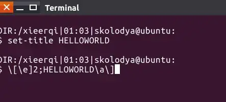

12
Videonauth's solution is bash-specific, meaning that if you use some other shell (such as korn shell or c shell or mksh or tcsh), it won't work. It also sets title via editing the PS1 prompt ( which for some reason has effect on the title in bash). Here's for example gnome-terminal with mksh:
