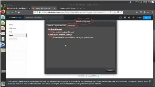

I recently changed the flavor from Unity to Mate and faced the same problem. I found a solution, hope it helps.
central panel -> ibus preferences -> advanced
unmark keyboard layout & global input method settings.
