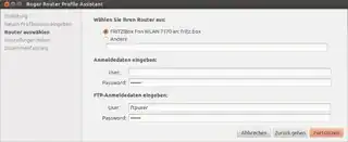

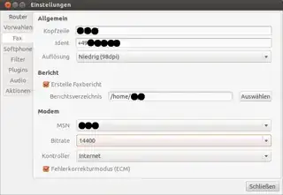

I ended up with a completely different solution, which I also want to share here after using it now for almost 2 years. My Brother MFC isn't involved in it at all.
As I'm using a Fritz!Box to connect my home to the Internet and telephony network, which has fax capabilities integrated, I've set that up there and then used Roger Router – which, among other things, provides a fax interface LibreOffice/OpenOffice can interact with directly. Setup of Roger Router is pretty easy and straight-forward, with each step explained, and your Fritz!Box even detected automatically.
Assistant Fax Settings
The Assistant starting up // Fax Settings (source: Ubuntu Wiki)
As a side-effect I get a bunch of nice-to-have functionality such as a local protocol (from which one can listen to recorded calls or view incoming/outgoing faxes) and desktop notifications of incoming/outgoing calls. I even can manage my Fritz!Box address book via Roger Router.
