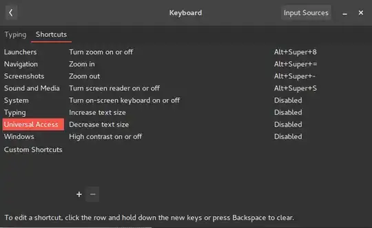

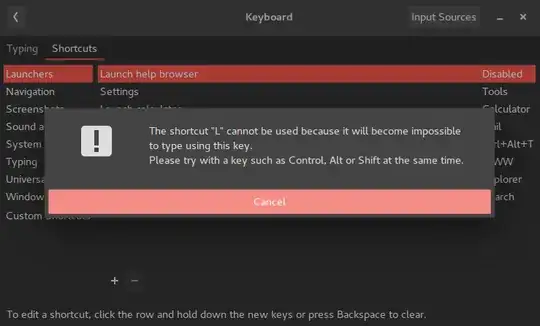

I would recommend navigating to Gnome Keyboard:
Settings -> Keyboard -> Shortcuts (tab)
Double check the Launcher Help Browser as well as On-Screen Keyboard shortcut in the Launcher and Universal Access categories respectively. The Backspace key should unassign the shortcut and mark it as Disabled. As for the shortcut assigned to your Backspace key, you will have to do a little detective work and follow the same steps. Universal Accessimpossible to typeUnfortunately, I was unable to recreate the same issue and wish you the best of luck!
