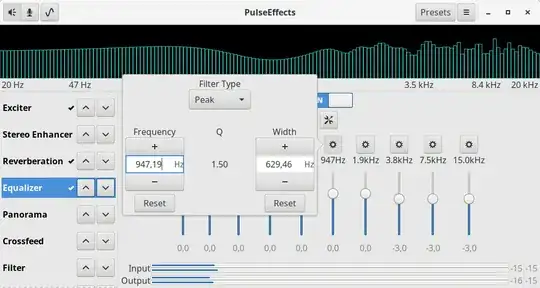

PulseEffects provides a "limiter, compressor, reverberation, equalizer and auto volume effects for Pulseaudio applications":
According to the installation instructions, to install on Ubuntu >= 18.04:
sudo add-apt-repository ppa:mikhailnov/pulseeffects -y
sudo apt update
sudo apt install pulseeffects pulseaudio --install-recommends
An older version which should install on Ubuntu 16.04 is available in this PPA: https://launchpad.net/~yunnxx/+archive/ubuntu/gnome3/
