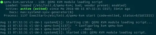

Update addressing your comment that you still have a not running qemu-kvm service listed :
This is a startup service which is running when you additionally installed the qemu-kvm package.
qemu-kvm
You have two options, you can disable the service with systemctl disable qemu-kvm or you can remove the service with sudo rm /etc/init.d/qemu-kvm. To also remove the configuration file, execute sudo rm /etc/init/qemu-kvm.conf. Now reboot the system - the service will be gone.
