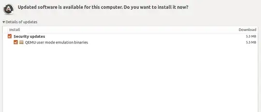

I installed QEMU from software center but removed latter (using software center). But updates are recommended to QEMU (see screen shot). That means QEMU is not uninstalled properly. How can I completely remove QEMU from my computer?

Using the Terminal
Uninstall just qemu with
sudo apt-get remove qemu
Uninstall qemu and it's dependencies with this
sudo apt-get remove --auto-remove qemu
If you want to purge all the config and data off the system you can also use
sudo apt-get purge --auto-remove qemu
