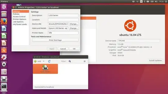

Here's the proof on how this worked out:
