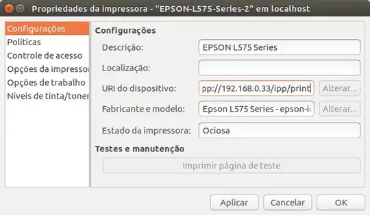

Here is a screenshot from where I change it:
Screenshot of configuration screen where the printer URI can be changed.
