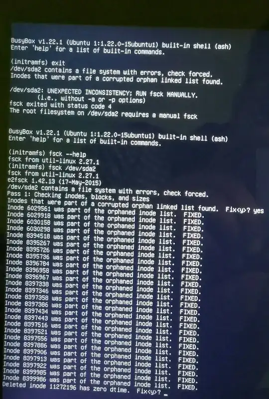

I did like this and followed by reboot command
enter image description here edit 1 I then came to conclusion that the image in the USB Drive is corrupt. So I rebuild the bootable image.
