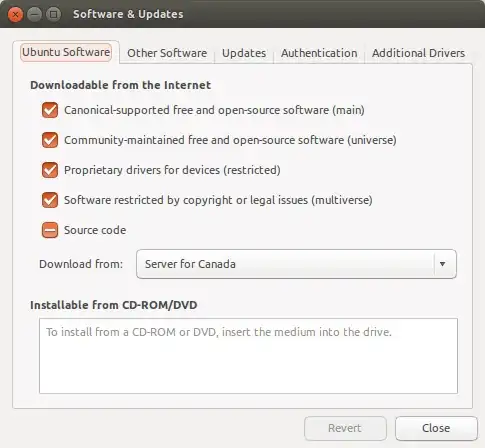

I wrote a couple of scripts to help users pull their current kernel source package, apply some patches of mine, and build it as a .deb package with make-kpkg. One of the few steps that requires manual intervention is enabling the "Source" downloads via:
  • "Ubuntu Software Center"
    • Edit...
      • Software Sources...
        • "Source Code"
Is there a way to do this automatically via the command line? It's to my understanding I could just un-comment the first few "deb-src" lines in /etc/apt/sources.list, like so:
