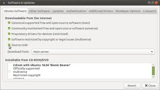

by choosing from Software & Updates, sources in first tab... and by running "sudo apt-get build-dep pspp " the libgtksourceview-3.0-dev is installed....
then... running sudo ./configure for pspp v1.4. is working. It was installed successfully!
You have to start the compilation process by getting build-dependencies for 18.04 LTS version:
  1. Enable Source Code repositories by visiting Software & Updates (software-properties-gtk)
    Software & Updates → Ubuntu Software
    then confirm lists Reload.
  2. Get build-dependencies with:
