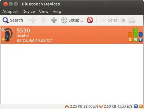

Image #1 - Bluetooth is connected to Bluetooth card in PC (screen shot is of 'blueman' software as suggested in Bluetooth won't find devices!): enter image description here

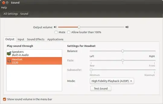

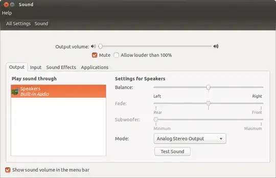

Image #2 - Core of problem, no option to output sound to connected Bluetooth device: enter image description here

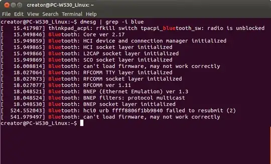

Image #3 - when I run dmesg | grep -i blue the result is as follows (confirms the issue is a firmware problem):
firmware issue image

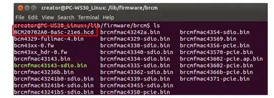

I have spent over 8 hours looking through posts on this issue, and I can say that out of very many posts with similar unanswered issues, there is a gem which explains how to fix this issue. Have a look: Bluetooth Broadcom 43142 isn't working I followed this instruction manual to the T! The only problem is that it didn't work for me. The image below shows the final step of the solution to the post I linked to. Now, does it not work for me because the *.hcd needs to go to a different location (as everything else is *.bin) in addition to this location? Could it be the naming of the hcd file? Is there some command to force load the *.hcd file into the kernel? do I need to remove some other piece of software? Can I load the driver I created using 'System Settings' > 'Software and Updates' > drivers tab?enter image description here

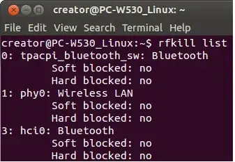

  3. Also, no wireless signals have been disabled: enter image description here

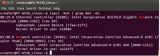

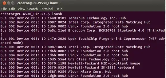

********************************Edit #1**************************************
Some more commands:

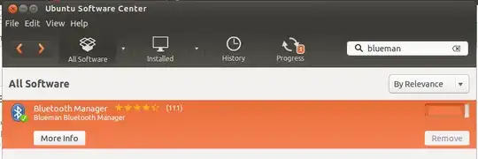

In my post I already worked through Pilot6's fix (step 1); but my bluetooth device was still not playing music (Was connected but still not playing music). Next I uninstalled blueman using software center:
At this point do a restart. After the restart there will only be one bluetooth logo (instead of two) enter image description here
At this time pair the chosen device as usual. Now when you go to sound settings, you will see the Bluetooth device.
