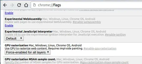

I had same problem, setting GPU rasterization to 'Force-enabled for all layers' seems to be finally working:
Chrome Flags: GPU rasterization

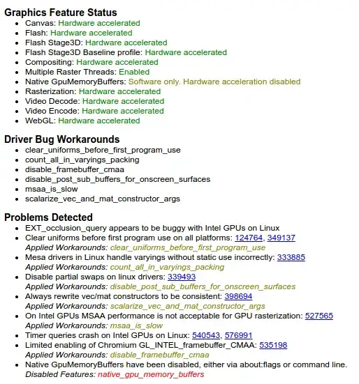

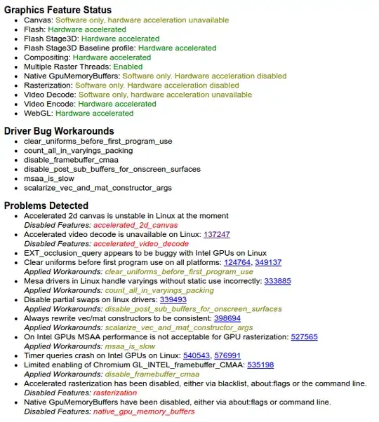

None of these answers seemed to help me. What I ended up doing which seems to have fixed it (My reference was this site http://www.bang-olufsen.com/ which flickered like CRAZY and now it works smoothly) is this:
1.- Navigated to chrome://gpu/. This is what it showed:
2.- I tried fixing the problems one by one. In my case, enabling these flags fixed some of them: GPU rasterization, Override software rendering list. Then it showed like this:
3.- I edited the desktop launcher and added the parameters --disable-gpu-driver-bug-workarounds --enable-native-gpu-memory-buffers.
4.- After that, no more problems detected, everything shows as "hardware accelerated" and, more importantly, no more flickering:
If you add the parameters to the launcher first, the list of problems should be shorter and it'll probably be easier to figure out which flags will help you with the problems you have left.
