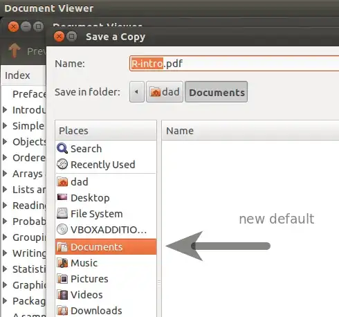

The following is one way way to force evince to default to the Documents folder rather than the previous recently used.
In summary, the source is changed to obtain the default Document folder and set this as the default folder for the Save-As dialog.

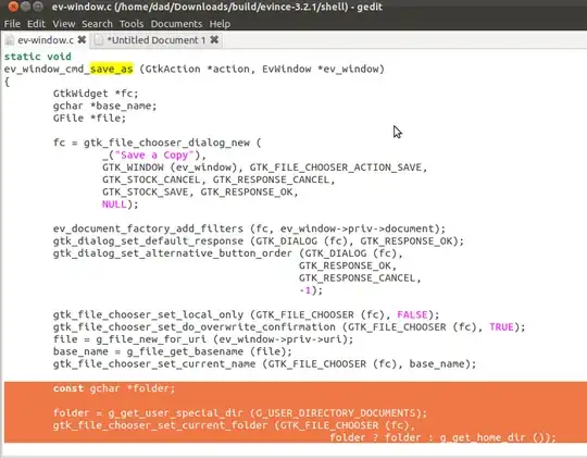

make the change
Open ev-window.c
gedit shell/ev-window.c
Copy and paste the following into the file at the position shown in the image
const gchar *folder;
folder = g_get_user_special_dir (G_USER_DIRECTORY_DOCUMENTS);
gtk_file_chooser_set_current_folder (GTK_FILE_CHOOSER (fc),
                             folder ? folder : g_get_home_dir ());
Save and close gedit
