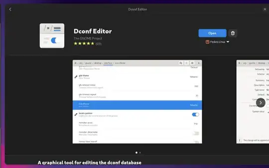

last-folder-uri will get changed the next time you use the file chooser, instead you need to set startup-mode:
Install dconf-editor via Software center:
Gnome software entry for Dconf Editor

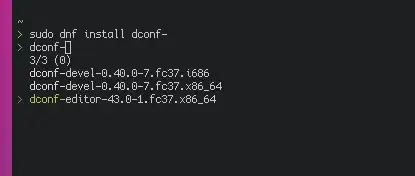

or via cli
autocomplete output of dconf attempting to install dconf-editor
sudo dnf install dconf-editor
