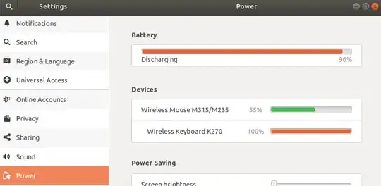

  • This is a pretty common behavior with wireless mouses when they are running out of battery. If that's your case check on a terminal with
    upower -i $(upower -e | grep mouse)
    or with GUI, gnome-power-statistics or in Gnome Shell Power Settings:
    screenshot
