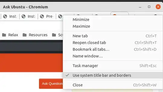

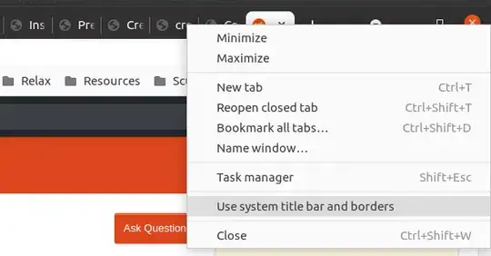

In the latest build of Chromium, version 94 now, the Menu ⇒ Settings ⇒ Appearance ⇒ Use system title bar and borders option is no longer available there.
What you need to do to access this option is Right Click in any empty space in the Tab Bar and select or deselect the Use system title bar and borders option from the drop down menu, as shown in the screenshots below below.
Use system title bar and borders option - Selected: Use system title bar and borders - Selected
Use system title bar and borders option - Deselected: Use system title bar and borders - Deselected
