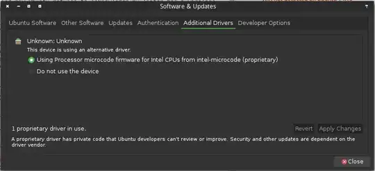

Which seemed to be successful, and a plethora of other things I've found on the 'net all to no avail. The Additional Drivers screen of Software and Updates has one entry, which it either claims is unknown or not working correctly.

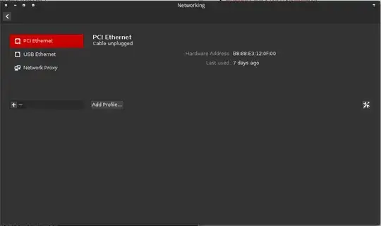

Network Settings is short an entry (on the left, there used to be a "Wifi" device or so):
asdasd
(Before you ask, no, the little plus sign is not helpful.)
