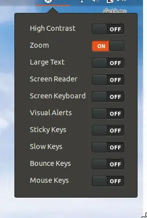

I tried above commands did not work. I was also having my mouse pointer real slow all of sudden in properly working Ubuntu 18.04. Googled like crazy for about an hour, tried restarting for few times, checked RAM and CPU usage it was not even half, try unplugging the mouse for couple of times, went through the mouse settings,
Finally, found out the Zoom was switched on. Switched it off and worked like a charm.
The option can be found in Settings > Universal access.

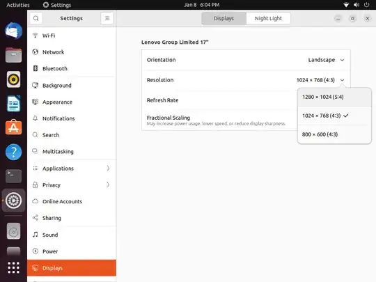

I had the same problem when using Ubuntu 22.04. I tried to use another USB slot but that didn't work.
I did a little research and found a solution that worked:
  • Launch Settings app.
  • Select Displays.
  • Change the Resolution from 1280x768(5:4) to 1024x768(4:3)
screenshot here

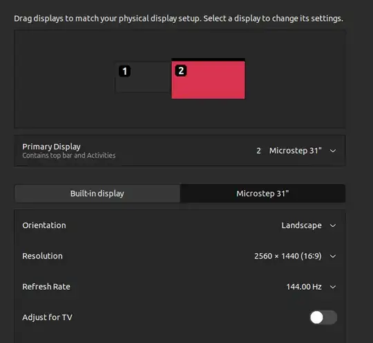

2024 answer:
If anyone also "feels" lag like me, it's the refresh rate.
Make sure you choose the right screen, set the right resolution (for me 16:9 works well) and choose refresh rate > 144Hz.

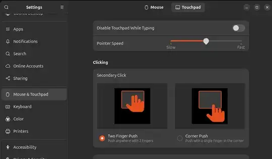

I tried the solutions above no no avail. I have a MacBook Air late 2015. The comments got me thinking and I turned off the disable mouse pad while typing and that solved my mouse freezing issue. Hope this helps someone.
