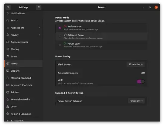

I was able to resolve the lagging issue by changing the USB Dongle to a different USB Port and also, in Ubuntu 21.04, I navigated to
Settings -> Power-> Performance Mode (Selected)
and it worked for me.
check the settings from this picture

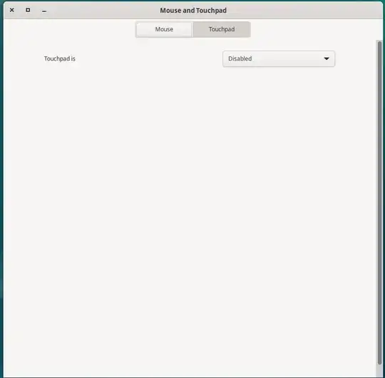

For me disabling the touchpad sped the mouse back up a bit. I will have to figure out the keyboard next.
