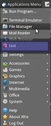

I'd like to add some items to my Xfce "root menu", see picture for location:

As the picture shows - "test" is a root menu which has been added.

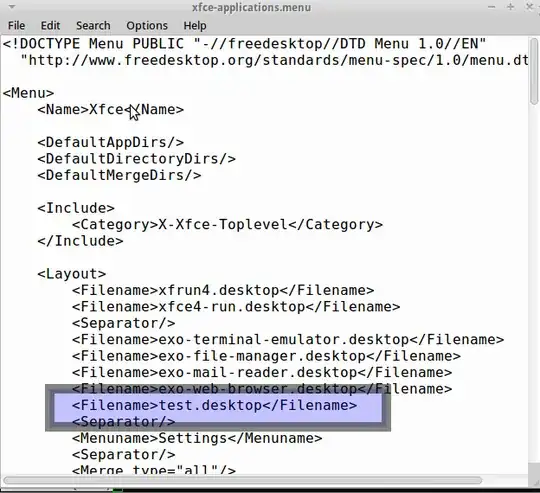

Edit our custom menu:
leafpad ~/.config/menus/xfce-applications.menu
Add a new entry as shown:
