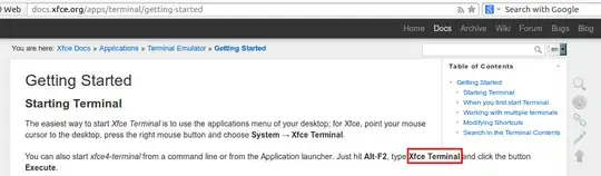

To access the Xfce4 Terminal from the Alt+F2 screen, one has to type
xfce-terminal
and then click the Execute button. See how over here: http://docs.xfce.org/apps/terminal/getting-started (but note that typing Xfce Terminal as mentioned in the link may not work whereas xfce-terminal will).
xfce doc
To know more about the two modes of the Alt+F2 screen, take a look at http://docs.xfce.org/xfce/xfce4-appfinder/usage.
