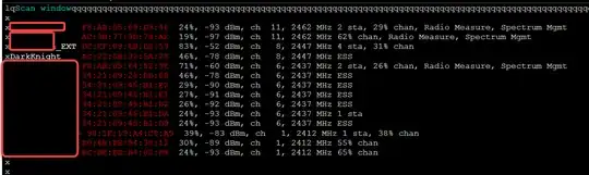

If you can install software on your machine, I would recommend wavemon.
To install it run:
sudo apt-get update
sudo apt-get install wavemon
To run it:
sudo wavemon
Then press F3 for the scan window. You should see something similar to this:
wavemon scan window
