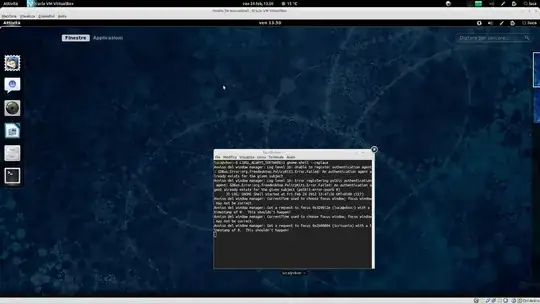

Most people are testing in a virtual machine (Virtualbox or KVM). Gnome-shell in Virtualbox , VM = Ubuntu precise (12.04) using the ppa below.
gnome-shell

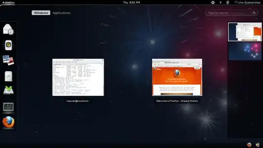

The first option is to try it on Fedora 17 Alpha (it is installed and configured by default)
Here is a screen shot of gnome-shell running on my gma500 in Fedora 17 aplha
gma500
