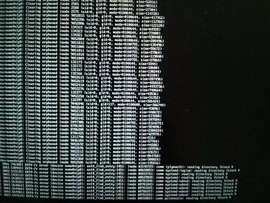

I have a dell Xps 15 9550 and I have installed Ubuntu Gnome 15.10 in the UEFI dual boot along with Windows 10. Ubuntu works fine but after running for a while it goes to the black terminal screen with these errors:
Image for error
I tried doing fsck but I am not able to unmount /dev/nvme0n1p8 as it says that the device is busy
It has SSD and the partitioning is:
/dev/nvme0n1p1      2048    1026047   1024000   500M EFI System
/dev/nvme0n1p2   1026048    1288191    262144   128M Microsoft reserved
/dev/nvme0n1p3   1288192  315672247 314384056 149.9G Microsoft basic data
/dev/nvme0n1p4 315672248  648951642 333279395 158.9G Microsoft basic data
/dev/nvme0n1p5 982083584  983005183    921600   450M Windows recovery environment
/dev/nvme0n1p6 983005184 1000214527  17209344   8.2G Windows recovery environment
/dev/nvme0n1p7 648951808  649537535    585728   286M Linux filesystem
/dev/nvme0n1p8 649537536  948848639 299311104 142.7G Linux filesystem
/dev/nvme0n1p9 948848640  982083583  33234944  15.9G Linux swap

The file systems containing Ubuntu seems to be damaged. Please start from a Live DVD/USB, open a terminal (Alt+F2) and run:
sudo e2fsck -p /dev/nvme0n1p7
sudo e2fsck -p /dev/nvme0n1p8
This either fixes the issue or uncovers more underlying issues.
