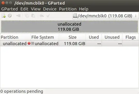

Here is what gparted sees. It will not create a partition table for this disk in any format: gparted display

If you can look into fdisk -l output, on last line it states:
Disk /dev/mmcblk0 doesn't contain a valid partition table
  • This means your SanDisk Extreme PRO SDXC 128GB card has either lost it's Partition Table or it has been corrupted.
To create new partition table on MSD/USB you can use GParted,
Choose: Device → Create Partition Table, Select New Partition Table Type, and click on Apply. It'll create a new partition table on MSD/USB. Don't forget to click on Apply All Oeration(Green Right mark below menu-bar)
You can refer GParted Documentation, Search for Creating a New Partition Table, same steps are there.
