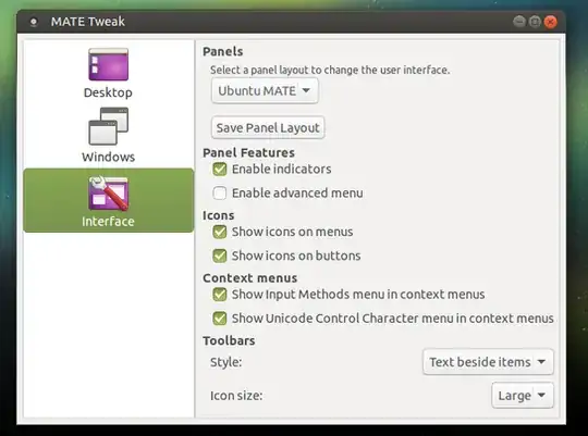

- Ubuntu Mate users need to enable the use of indicators on their system: choose System > Preferences > Look and feel > Mate tweak > Interface > "Enable indicators"

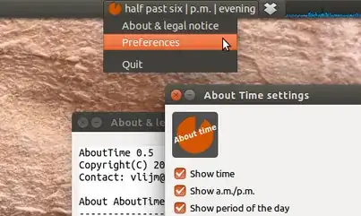

As per today (2016-4-9), a ppa of a polished version is available. To install from ppa:
sudo apt-add-repository ppa:vlijm/abouttime
sudo apt-get update
sudo apt-get install abouttime
The day periods in this version are changed, compared to the script version above, now it is:
morning 6:00-12:00
afternoon 12:00-18:00
evening 18:00-24:00
night 24:00-6:00
... and the indicator has tho option to change the icon during daytime:
morning/afternoon/evening/night:
As mentioned, this version was tested on both Mate (from the original question) Unity and Xubuntu.
