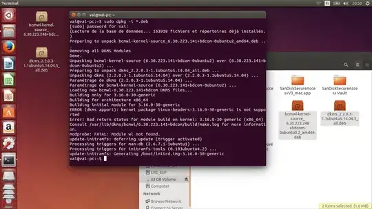

first i cp pool/main/d/dkms/dkms_XXXXX.deb and pool/restricted/b/bcmwl/bcmwl-kernel-source_XXXXX.deb from my key in my home, then i did sudo dpkg -i *.deb. Then i download this: http://mirrors.kernel.org/ubuntu/pool/restricted/b/bcmwl/bcmwl-kernel-source_6.30.223.248+bdcom-0ubuntu0.2_amd64.deb (64-BIT DRIVER FROM UBUNTU REPOSITORY) and I retry dpkg again: not working... (reboot done)
Here is my screenshot: (after trying to dpkg the 2 .deb in my bottable key, i download the 64BIT-DRIVER in an other key and i retry like I said to dkpg the downloaded one)
dpkg *.deb the 64bit driver
EDIT 2: Ok, it seems i have installed a wrong version... How can i remove driver i've just downloaded ?
