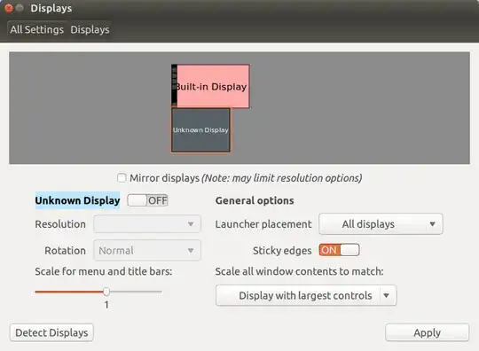

Edit: the fix in the answer below worked for a while, but the issue occurred again today (for the first time in several weeks). I think it's related to accidentally hitting windowskey+P -- see How to stop Mod4-P from switching the display?.
Here's a screenshot showing the second, "bad" display:
displays

I don't know why it would switch but as a temporary solution does doing xrandr to force it to the specified mode you want work?
xrandr --output LVDS1 --mode 1366x768
You can also check this article for more useful information: https://wiki.ubuntu.com/X/Config/Resolution#Setting_xrandr_changes_persistently
