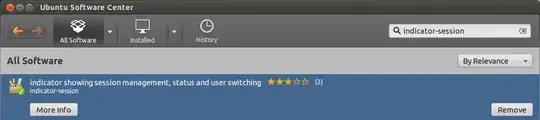

Hit Alt+Ctlr+T to open terminal and run the respective command of any indicator you want to remove. You can also use Software Center to remove indicators, Just search for the indicator you want to remove.
  • Session Indicator
    sudo apt-get remove indicator-session
    Or search for "indicator-session" in Software Center.

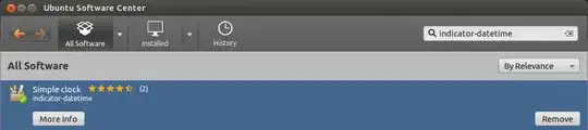

  • Date & Time Indicator
    sudo apt-get remove indicator-datetime
    Or search for "indicator-datetime" in Software Center.

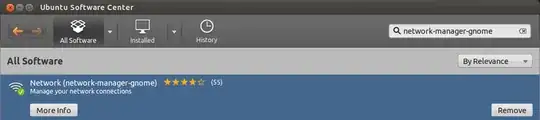

  • Network Indicator
    sudo apt-get remove network-manager-gnome
    Or search for "network-manager-gnome" in Software Center.
