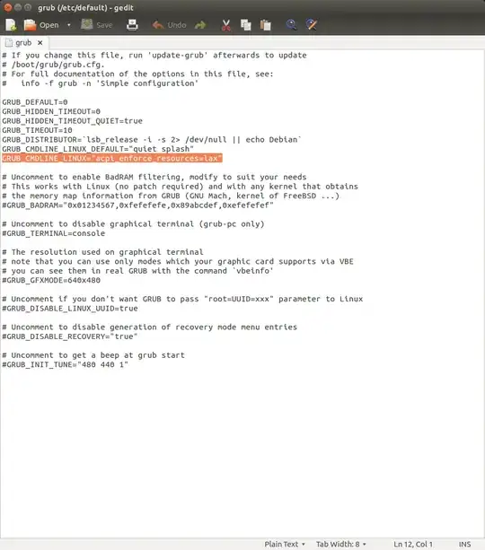

So you have run sudo sensors-detect accepted its defaults and allowed it to add it87 and coretemp to /etc/modules yet you don't see the outputs from the it87 chip.
If you run lsmod from a terminal you will find coretemp but it87 is not there.
The answer is to edit /etc/default/grub. You need to append acpi_enforce_resources=lax at the end of the line GRUB_CMDLINE_LINUX. Here is a screenshot of mine with the relevant line highlighted.
screenshot of my etc/default/grub
Then sudo update-grub followed by a reboot.

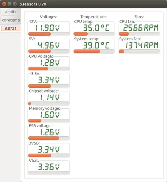

The it87 sensor outputs will now appear. You will then need to create or find a configuration file for your motherboard and insert it in /etc/sensors.d.
If done properly this will give meaningful names to all the temperatures, voltages and fan speeds detected, discard outputs from any sensors not connected to anything, set reasonable limits and calculate the values of voltages sensed using voltage divider resistors. Here is a screenshot of my it87 outputs using xsensors.
Screenshot of it87 output from my PC using xsensors
