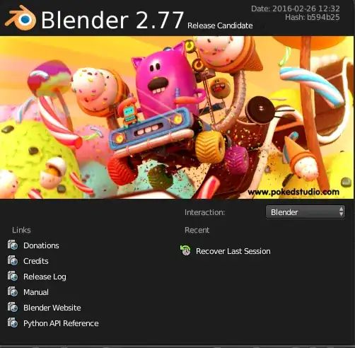

You might be better by using this PPA:
sudo add-apt-repository ppa:thomas-schiex/blender
sudo apt-get update && sudo apt-get upgrade
Sudo apt-get install blender
I installed this on Trusty Tahr and the latest version was successfully installed:
If you also wish to see the file locations from this package simply run:
dpkg-query -L blender
More details on this aspect can be seen here...
