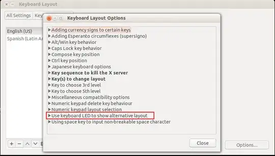

In Ubuntu 13.10 and older there were a keyboard layout option "use keyboard led to show alternative layout", so I could use it to have caps lock LED indicating current keyboard layout.enter image description here Now there is no keyboard layout preferences. I tried to use gnome-tweak-tool, but there is no that option too. Also I tried to type in console:
