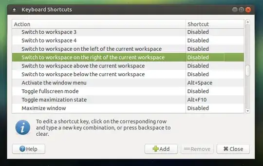

To change or disable the workspace-switch keybindings manually, choose:
System > Preferences > Hardware > Keyboard Shortcuts > Window Management (section)
Then simply click on the shortcut key (on the right) and press Backspace to disable the shortcut.
You could of course set another one alternatively.

For the workspace actions to show up in the Keyboard Shortcuts list, you may need to have at least two workspaces configured. On my machine, I had already disabled all the workspace functionality, but the keyboard shortcut was still being intercepted by Gnome. Reenabling workspaces and setting it so there were two available caused the actions to reappear in Keyboard Shortcuts so that I could remove those shortcuts.
