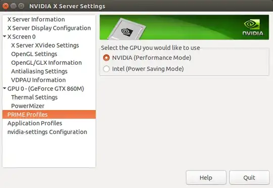

Yes, you can:
  • Open NVIDIA X Server Settings.
  • Go to PRIME Profiles.
  • Select Intel.
  • Log out and back in or reboot.
Now you are using Intel graphics.
Update addressing your comments that you cannot access NVIDIA X Server Settings:
To open NVIDIA X Server Settings press the Super key (it's the Windows key) and type "NVIDIA".
If it doesn't appear, maybe the installation of the NVIDIA drivers is not complete.
In that case, open a terminal and execute:
sudo apt-get update
sudo apt-get install nvidia-prime nvidia-settings
Then look for it again and you will find it.
