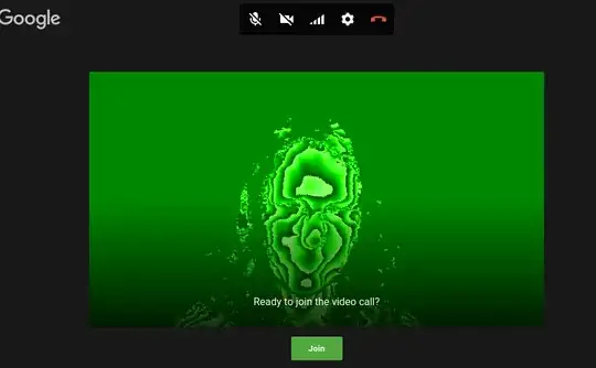

I am running a Dell Inspiron 5556 with Ubuntu 15.10. Just got linux on it and things are mostly good.
I am able to run hangouts fine in Firefox. However, in Chrome, the video is completely green. I have been unable to find references to this phenomenon.
green video screenshot

This happens because you have a laptop equipped with an Intel RealSense camera. The camera is meant for motion detection and the lines you see are distance contours.
I had the same problem. It turned out that /dev/video0 was pointing to this camera instead of the webcam (which was at /dev/video1). The camera used for other webcam-based applications in Google Chrome can be set through Settings -> Content settings -> Camera, but Google Hangouts does not respect this choice and insists on using whatever is at /dev/video0 (perhaps because the choice is made through the Google talk plugin rather than Chrome).
I solved this problem by writing a bash function to switch /dev/video0 and /dev/video1 so that Hangouts picks the right camera. Clearly a hack and there should be a better way to do this, but it works!
At least as of now, you can select the camera device in Google Hangouts: click on vertical ... -> Settings -> General tab -> Video and select the desired camera from the drop down.
