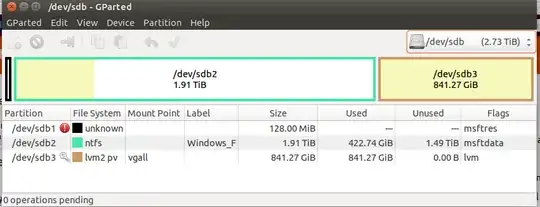

Within Linux one can make use of Logical Volume manager to create logical volumes which can span across drives and gives you a lot of flexibility. I have one detailed thread here where i am using /opt within LVM. That page has lot of other pointers which you can read for your reference.
A LVM(/dev/sdb3) looks like this in Linux's gparted tool enter image description here
