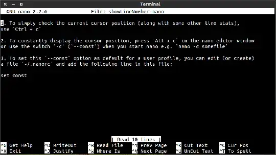

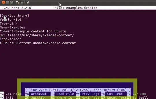

The keyboard combination to display the current line number whilst you are using nano is CTRL+C.
Alternatively, to display the line & column number position you could just use the -c parameter when launching nano i.e:
nano -c [filename]
To make this permanent, nano uses a configuration in your home folder ~/.nanorc
Thus to display line numbers always when using nano...
nano ~/.nanorc
(don't worry if its empty - this file doesn't exist by default)
type set constantshow
N.B. the deprecated syntax set const is shown in the animation
Save
animation1
