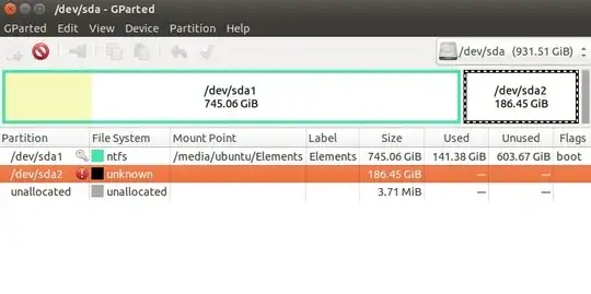

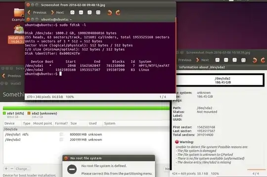

ORIGINAL PROBLEM,,,,,,,I've been using Ubuntu for a few years on a laptop and external hard drive which has two partitions, one for back-up duties (still works fine) and one for Ubuntu. Suddenly Ubuntu 14.04 won't boot and I am doing this from Ubuntu on CD drive. The Ubuntu partition shown in Gparted has no file system or mount point defined, and is marked black.
Gparted
fdisk, reinstall halt, more Gparted info
My questions are what may have happened, is the data and Ubuntu OS in this partition likely to still be present or has this partition been cleared, maybe by malware (is that likely?)? How to proceed? I imagine it's not a simple matter of redefining its file system to ext4?
