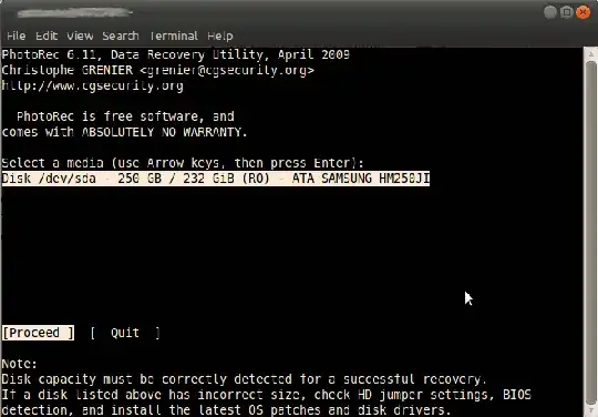

For Recovering files from internal and External hard drives there is PhotoRec which comes with TestDisk.
type photorec on your terminal
Select your drive and hit enter to proceed and follow the instruction.
