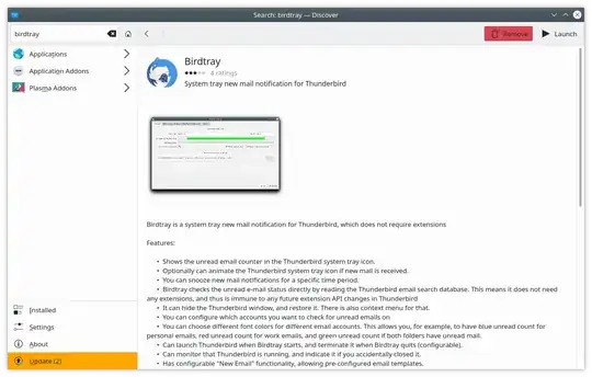

BirdTrayImage You can search for BirdTray from the Discover store:
However, after you install it there is a bit of setup involved to select all the mailboxes that you want to be notified for. Once you run the program, I suggest that you do that by right clicking on the tray icon and then clicking 'Settings...'. I don't remember all the steps after that but I am happy to update this answer based on your response.
It is a bit clunky because you have to be running both Thunderbird and BirdTray which are two separate programs. But it does the job for me for now.
Tested on Kubuntu 20.04.
P.S. Here is Thunderbird's open development ticket for that feature.
