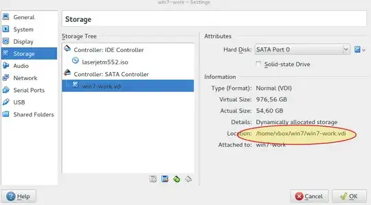

To check where you have yor disks, open "settings":

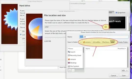

...as you see, I have mine in another partition --- namely one mounted on /home/vbox. To create the virtual disk (VDI) in a non standard place, you simply select the directory where to put it on creation (you can move it later too, in a lot of way, the most easy being to move the containing directory and put a symlink in its place).
choosing the VDI location
The VDI is a file as much as Linux is concerned, so you cannot put it in an unallocated space on disk2, so you have to partition, format and mount your unallocated space beforehand.
