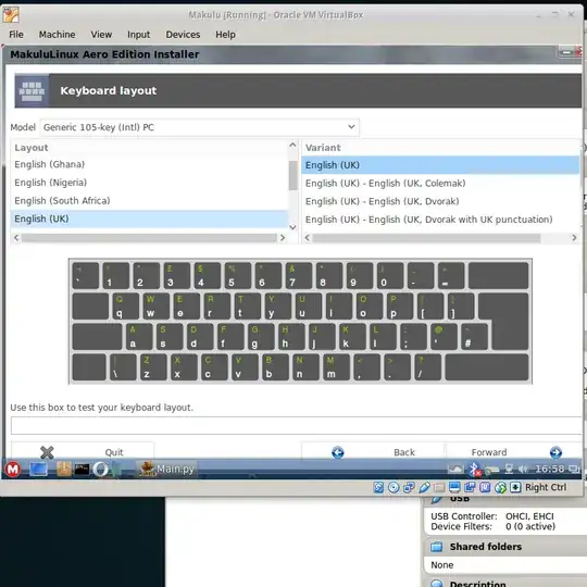

I have checked, you have installed the English (Queens own Great Britain) keyboard. What you need is the American English Keyboard, which is the one coming closest to the original IBM Selectric keyboard layout! Great Britain English keyboard layout: enter image description here As can be seen the At '@' sign is on top of the single quote button to the far right. Check your keyboard and load the right one (be sure to test it) take notice the keyboard do not in any way depend on the language or local settings! Happy Ubunting
