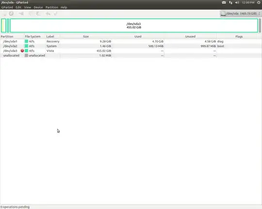

My family PC has Windows Vista and lately it has became unusable, having strange errors and taking hours to do anything at all, so I'm installing Ubuntu 11.10 alongside it. I went into GParted to resize the Vista partition but found that it had an exclamation point in a red circle next to it: GParted

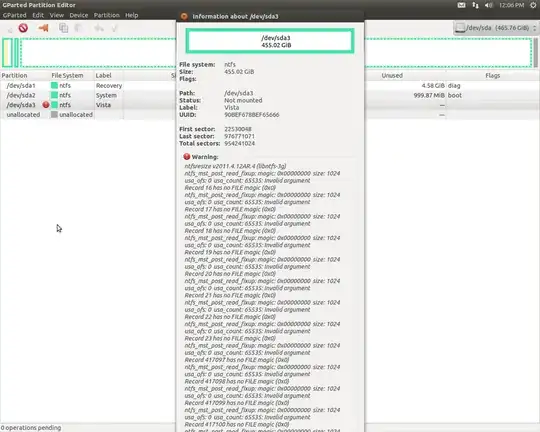

I tried to resize it but the Resize/Move button was grayed out. I thought that this might have to do with the exclamation point so I looked at the information and found a load of errors: GParted
What does the exclamation point mean? How can I resize my partition?

I turned on the PC and didn't realize it didn't have the Ubuntu CD in so it tried to boot into Windows. When I came back to it I realized it had started running chkdsk, because before I couldn't boot into safe mode I scheduled it to run chkdsk. After it completed the Vista partition no longer had an exclamation mark next to it and I am able to shrink it. It's currently shrinking now and its been on the real resize stage for a while but apparently it's normal if it takes a long time. (Extra info: I did cancel it because I didn't think anything was happening but it messed up the partition. Somehow chkdsk was scheduled again so I was able to resize it again. I'll be sure not to cancel it this time.)
So if anyone else has this problem, run chkdsk /r at Safe Mode with Command Prompt, or the recovery console if you have it (I don't).
