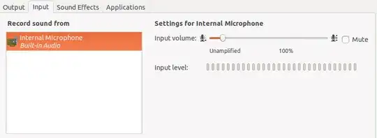

Try reducing the input volume in the sound settings. By normal the volume shouldn't be that high. Mine is shown in the picture.
Sound settings in Ubunut
