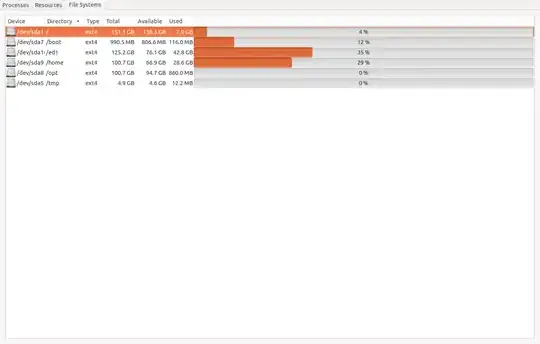

  1. / --> 100GB
  2. /boot --> 1GB
  3. /tmp --> Double the ram size
  4. swap --> Double the ram size
  5. /home --> 100GB
For the reaming size create any folder like
/ed1 --> whatever size reaming have

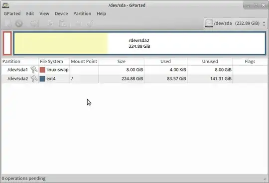

Find your amount of RAM (I have 8GB), You need to create a Swap Partition of at least this size. Then Create an ext4 partition for root (Linux-Ubuntu) of 20 or more GB - if you want to have your Home on a separate partition, I have chosen to have my Home on the shared with the root, remember to set mountpoint to root! enter image description here Remember to press the Apply Button (Checkmark) to write your settings to the disk! Happy Ubunting :-)
